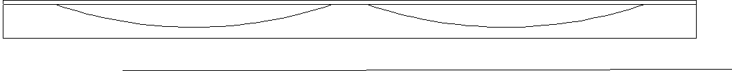

The idea I was thinking was not a new bracing pattern really, but a different way to brace the top.    Basically, instead of scaloping or doing the p******c thing, doing the inverse of that. The brace would attach to the top near the sides and in the middle for a x type pattern, and be cut away inbetween. hopefully the picture works. I think this would allow the top to vibrate more while still keeping it strong and stiff. Maybe I am over enginerring it though. what do you think

I think that I have seen pictures of this type of bracing. You may want to search the archives.
PostPosted: Sun Apr 16, 2006 3:34 pm
It's true John, there are examples of people that have used these 'bridge' type braces. You could search the MIMF forum archives as well...If it comes to me who has done this I will let you know.

I didn't figure I could have been the first one to think this up. I am curious if it works though. Also, how it would change the sound of the guitar.    I appreciate everyones quick response. this forum is great!

[QUOTE=Mustang_jt] The idea I was thinking was not a new bracing pattern really, but a different way to brace the top.    Basically, instead of scaloping or doing the p******c thing, doing the inverse of that. The brace would attach to the top near the sides and in the middle for a x type pattern, and be cut away inbetween. hopefully the picture works. I think this would allow the top to vibrate more while still keeping it strong and stiff. Maybe I am over enginerring it though. what do you think
Torres back in the 1860s used this style of bracing on his open harmonic bars, and some great builders, see Joshua French's site, use open bars now, on both classical and SS. I see no reason why they shouldn't be used more frequently.
The correspondents above are quite right in that most people just copy the Martin bracing pattern, because most people don't build enough guitars to develop their own pattern, so it makes sense to follow a tried and tested route. This is particularly true of those part time builders who sell their guitars because their choices are, to a large extent, driven by the market which is used to Martin bracing.
A number of the more adventurous builders have broken away however, have a look at Howard Klepper's site (you can't get much more adventurous or inspirational) he has developed his own bracing pattern. There are other examples out there, Jimmy Caldwell come to mind. Have a hunt round the OLF member sites.
That said until the principles and effects of bracing are fully understood or at least lightly grasped, a close variation on the Martin pattern is a good place to start.
